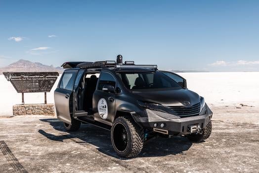

I told my wife the same thing, If Toyota ever releases that I am trading in my 2015 ASAP. One question though, how do the rear doors open with though fender flares?
