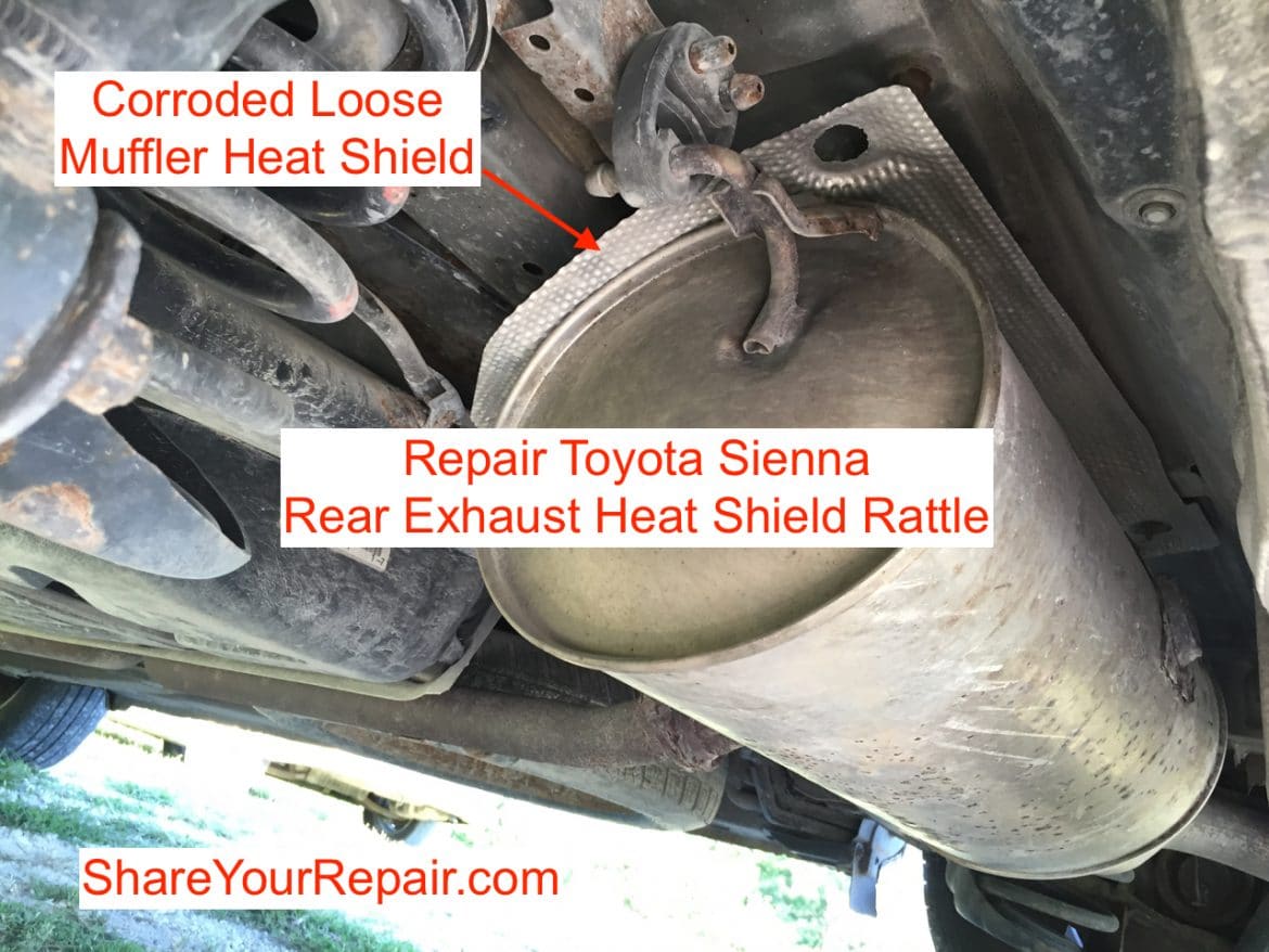

Thanks for the replies so far. I’ll try to get a pic as I think there is some confusion. It’s not the catalytic converter I’m referring to, but the heat shield that mounts to the vehicle body above the muffler.
it’s what the guy repairs at this link (the same repair method I used a few years ago that has failed now). It’s part number 6 in the diagram at this link.
A picture would help. Sure something could be rigged up. I wouldn't try to run without it. Your not hanging the exhaust, just a piece of sheet metal so maybe a little wire will work fine.
unfortunately this mounts to the body so there’s no easy way to secure it with wire.
Yeah, I’m inclined to leave it off, and that’s what the muffler shop said to do. I just want to be sure I’m not going to set the van on fire doing that. I have 4 kids and it’s our primary people mover, so I don’t want to take a foolish risk.
