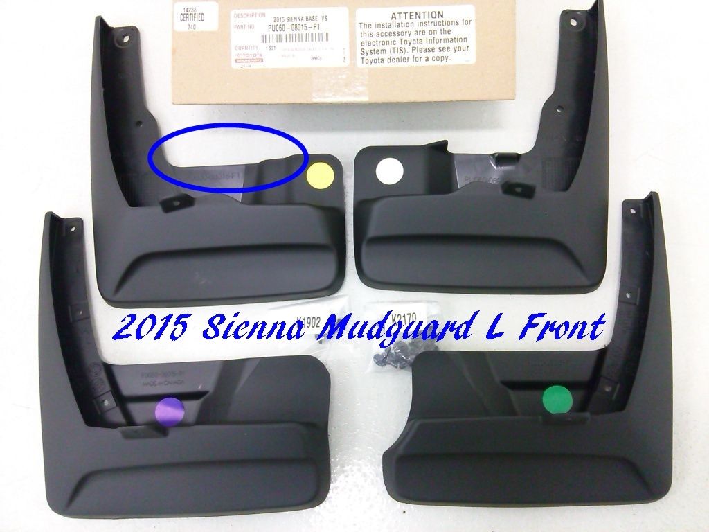

Just a heads up guys. You may want to make sure that the mudguards are for the 2015 model. Bought a mudguard set for 2011-2014 for my SE and it did not fit the fronts. Rears were OK.
Part # for 2015 LE/XLE/LTD mudguards is PU060-08015-P1 and PU060-08S15-P1 for 2015 SE.

That is true. You will not see gaps on the outside but you will see some gaps in the fender well area not too bad. But if you want the right one, then you may want to get the part number I posted. That is why there are part numbers for it.
Here is a comparison on the front L mudguards between the 2011-2014 vs 2015.
Ahhhh. Now I see. I was like I have no gaps against the painted portion. Small detail but yes there's a difference.
