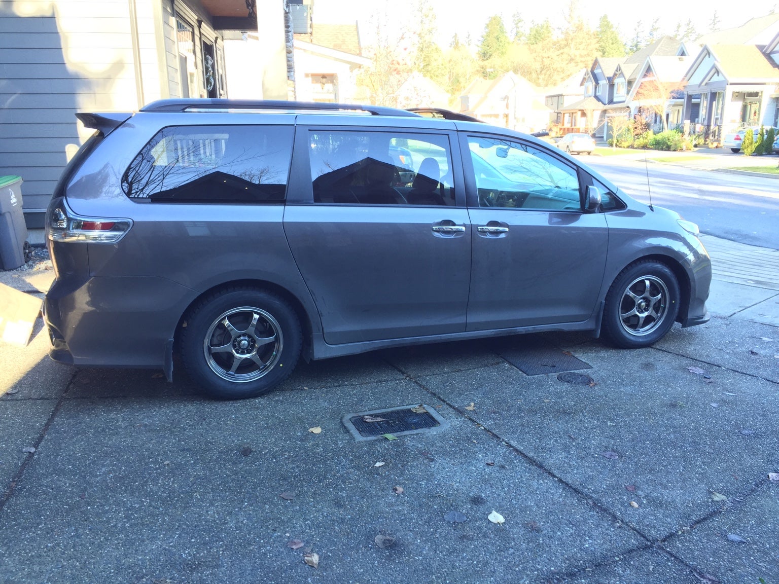

Just got mine mounted today. I went with the Blizzak WS-80's in 225/65/17. They're mounted on 17x7" 5Zigen RSX-6 wheels. My wife says they're kinda ricey, but they were only $150 for the set of 4. I double checked firmer and ET42 was just fine.

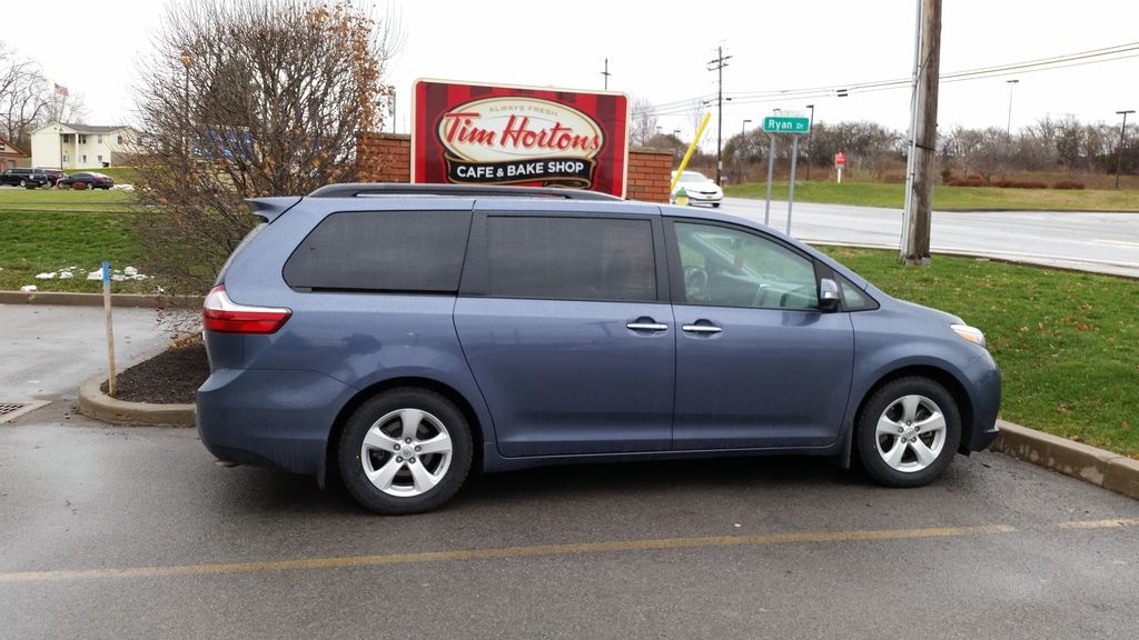

Winter tire package Bill of Materials for making a Limited look like an LE:
1) 4 new replacement grade Toyota Sienna 2011-2016 clone alloy wheels 17”x7” #69584 / 42611-08080 @ $127 each (incl tax & shipping) = $508
2) 4 Bridgestone Blizzak WS80 tires, 235/60-17 (102T) @ $120 each + shipping = $554 total, minus a $70 Bridgestone rebate card = $484
3) 4 TPMS sensors, Toyota/TRW system, 42607-0C070, $8 each = $32
4) 4 TPMS install kits, Standard Motor Products TPM1110K4 (4 pack, incl shipping) = $12
5) 4 Center caps 62mm, (OK quality knockoffs on Amazon) = $9
6) Assembly & balance at local tire store = $65
Total = $1,110
The "LE-ified" Limited captured live at a nice doughnut & breakfast spot outside of Rochester, NY around Thanksgiving.
