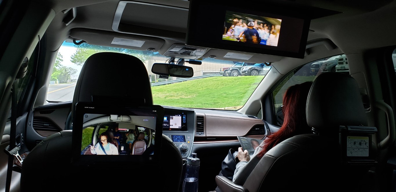

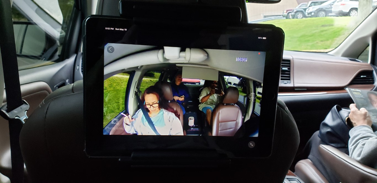

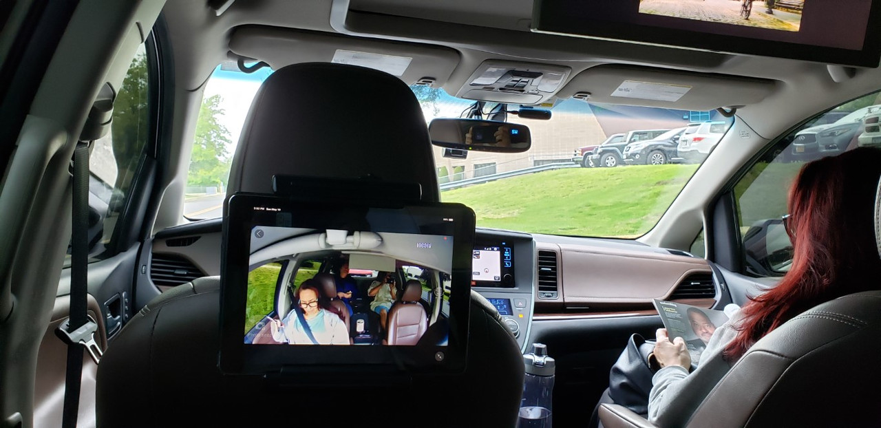

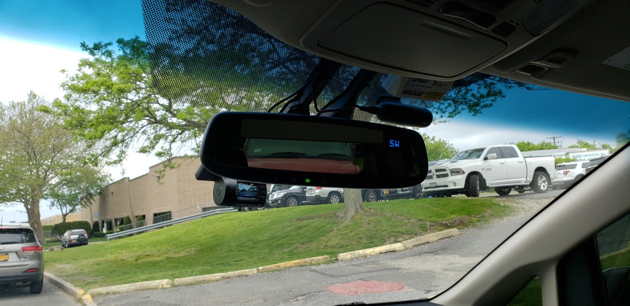

Anyways, I didn't go all out on my new Sienna like I've done with my other cars, but I did do a basic front/rear/interior cam setup

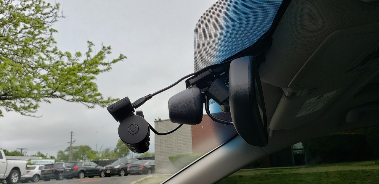

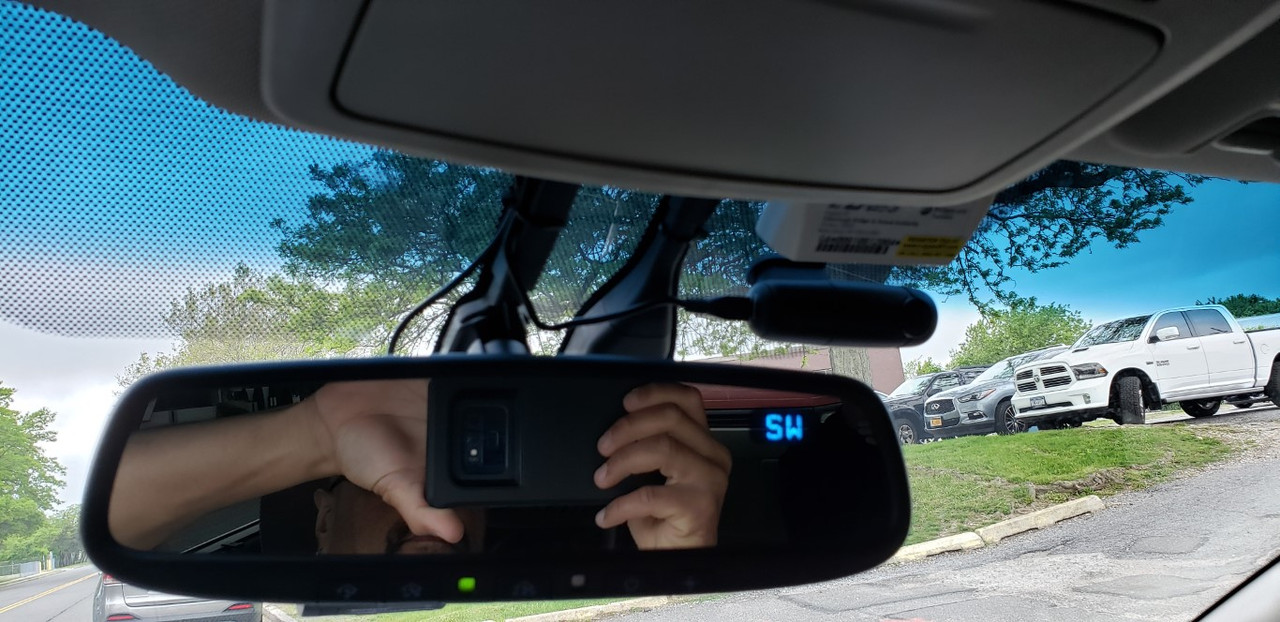

For front and rear, I used a Mini 0906
For the interior, a B1W
Both are from BlueSkySea, but there are plenty of knockoff names these models are sold under and they're all pretty much the same
For the cameras mounted up front, nothing was disassembled and the wires were simply tucked in between the headliner and weatherstripping.

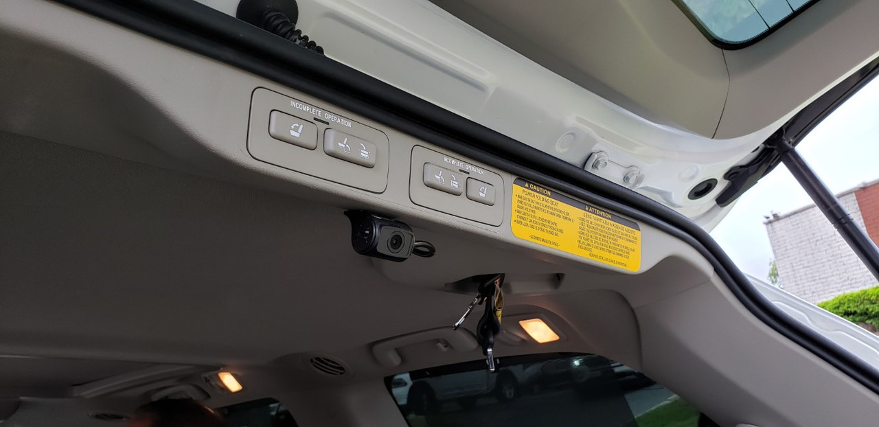

Same for the rear camera cable when I simply stuck it under the 3rd tow seat control buttons

That being said, I recently took the time to fish the cable through the hatch wiring tube grommet in order to mount the camera on the glass itself, which required popping off the wiper motor cover and dropping the switch panel.

Forgot to mention the cameras are hardwired to the fuse panel with LVC Parking Kits
Basically, the dash cams work normally when the ignition is turned on, but when it's turned off, it goes into parking mode, which records at a lower frame rate (you can also set it to record when there's motion in the field of view)
The parking kits also have an adjustable Low Voltage Cutoff to prevent battery drain.
