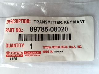

Thanks to everyone contributing in the discussion. I lost my key and successfully programmed a replacement as a new master key. Just to add another data point showing what works where, below is the info of the my vehicle, key, & programming steps.
Vehicle: 2008 Sienna LE (FWD)
Vehicle Manufacture date & location: 12/07 Indiana
Due to the urgency, I did not shop in the Internet. I bought the key from a local dealer for $48.50. The price includes cutting the key (but not programming). Dealer wants $150 to program the key which I declined. I personally do not mind on the $48.50 dealer pricing of the key as:
1. I know I got a genuine OE key (Toyota quality part).
2. Dealer freshly cut the key using data retrieved from vehicle VIN# (not duplicated from my existing somewhat worn-out key).
3. I got it the same day.
Information/identification of the key the dealer sold to me:
1. Toyota P/N: 89785-08020
2. Description: TRANSMITTER, KEY MAST
3. Has small dimple on the blade (per info found in the Internet, this is an identification for having 4D-67 chip; the right application for 2004-2010 Sienna and few other Toyotas).
Using the programming steps as shown in Youtube video posted by ovnisf in post #33 http://www.siennachat.com/forum/64-...-transponder-key-post1390689.html#post1390689, I programmed the new key on dealer parking lot; and at the end of the programming (step 6 below), I kept the engine running & drove home using the new key.
Programming steps:
1) Sat in the van driver seat with all doors closed but unlocked.
2) Inserted the original master key into the key cylinder (in and out) 5 times and left it there.
3) Opened and closed driver side door 6 times; left door closed on 6th time.
4) Removed master key from key cylinder. The red immobilizer/security light continuously lit.
5) Inserted the new key. The red engine immobilizer/security light blinked for a little over a minute, and then went out. Programming was pretty much completed as the light stopped blinking.
6) Started the van with the new key to confirm successful programming.
I noticed on earlier post by others that some of the steps (turn new key to ON during programming (might be part of step 5), and start w/ original master key (between steps 5&6)) are not needed.
Additional info I got:
When I asked how many keys total can be programmed to the vehicle, the Toyota part associate that helped me said the vehicle can only have 4 key max at a time.
