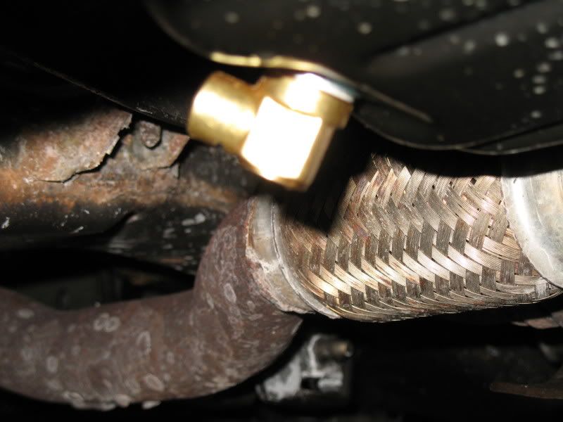

389 Posts
JC
That looks like a great set up my only concern what if a rock or something hits it or even if you would drive to far up to a parking curb? It is hard to tell from the pictures if it is vulnerable. Did or do you have any concerns ? Thanks

steelcity said:
JC
2,231 Posts
Steelcity,
The valve only comes down about an extra 1/2 inch. Not like It's a Jeep YJ or something like that. The exhaust pipes hang lower than the drain bolt. It makes changing oil much easier and there is no damage to the drain pan threads since you don't need to take it off. Oil takes a little longer to come out, but that's not a major issue.
The other good thing that is if you get another Toyota, you can use the valve on that vehicle. Fits all Toyota's!
Regards, Jason.
