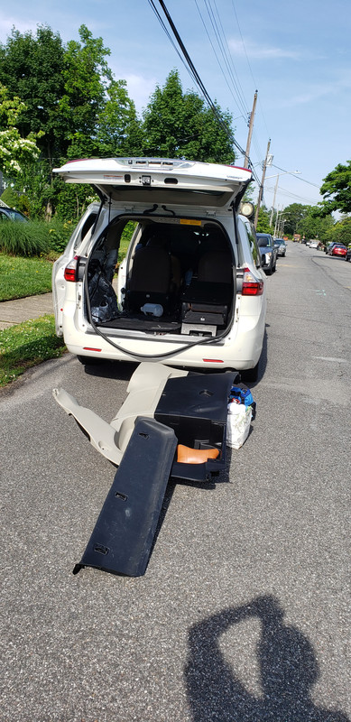

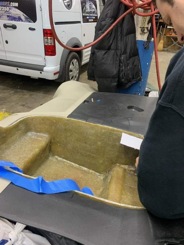

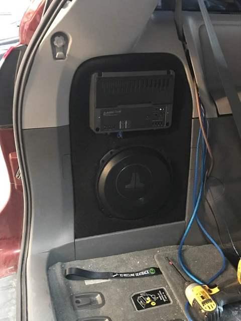

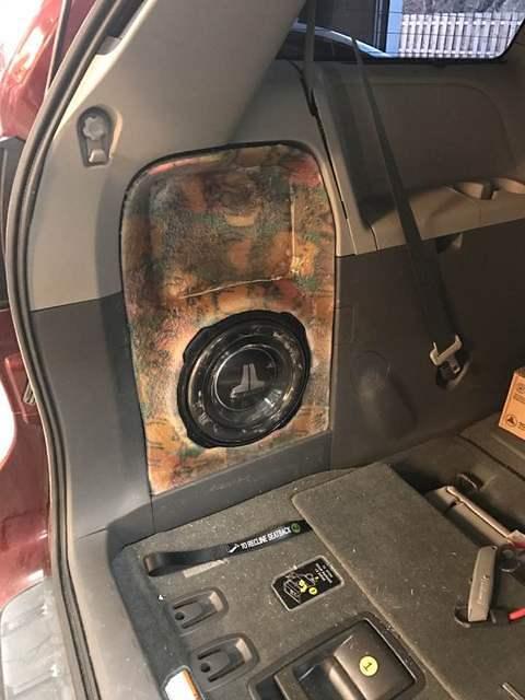

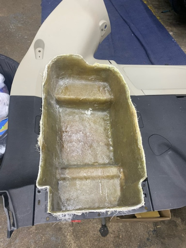

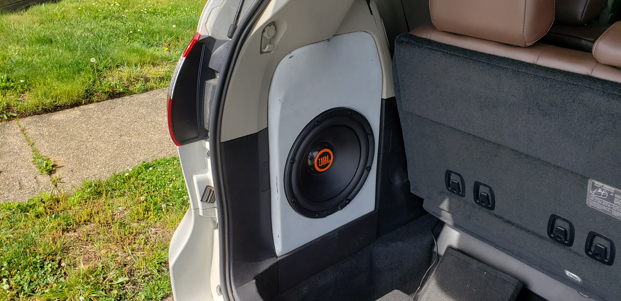

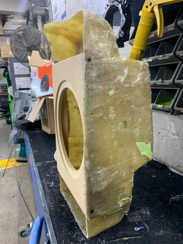

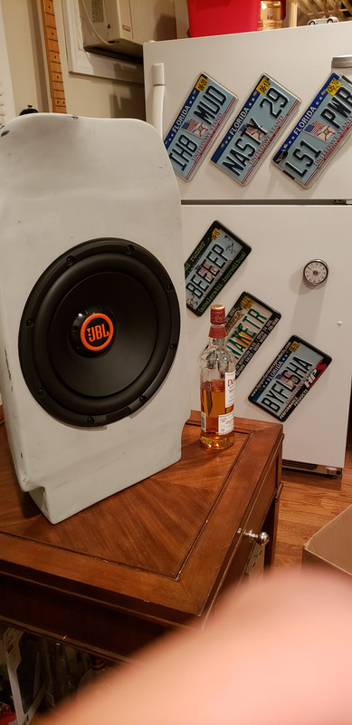

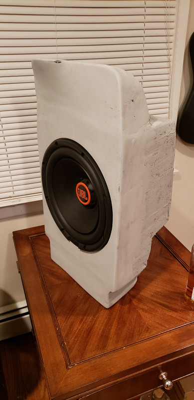

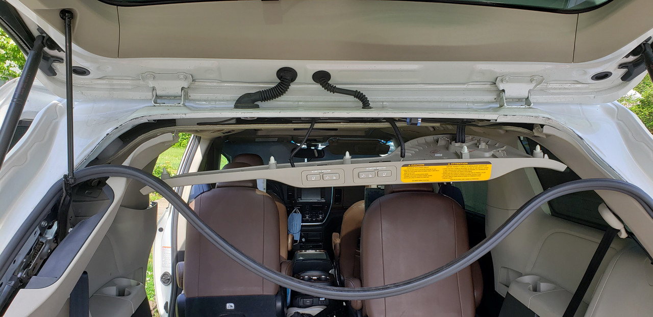

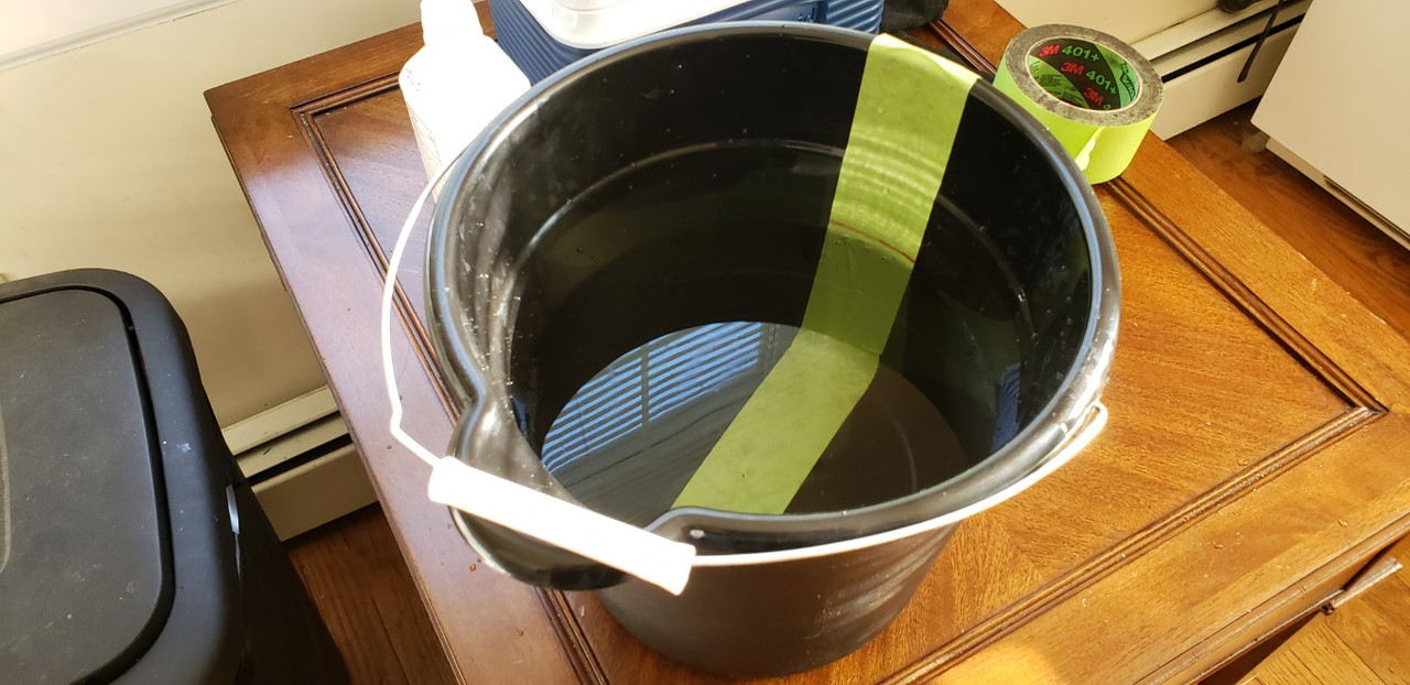

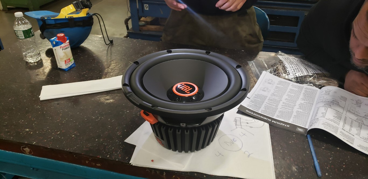

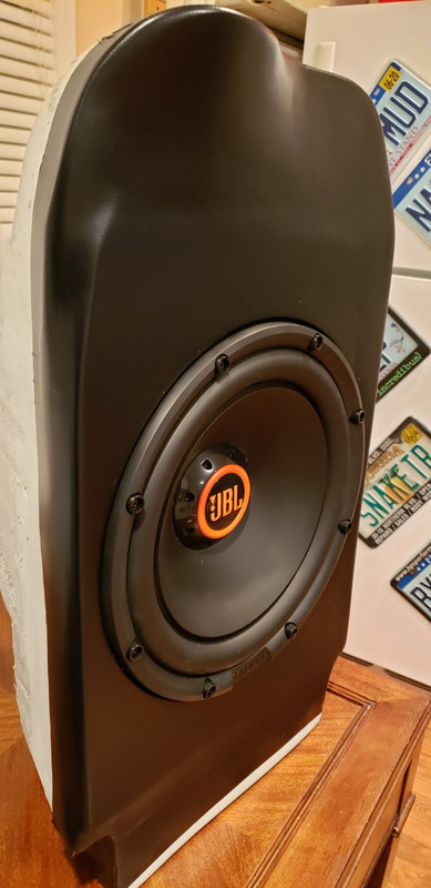

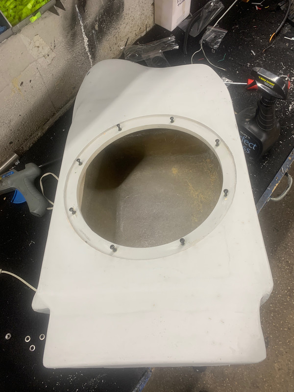

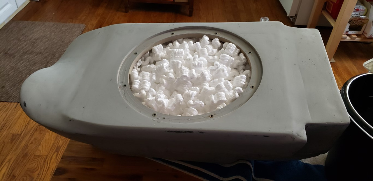

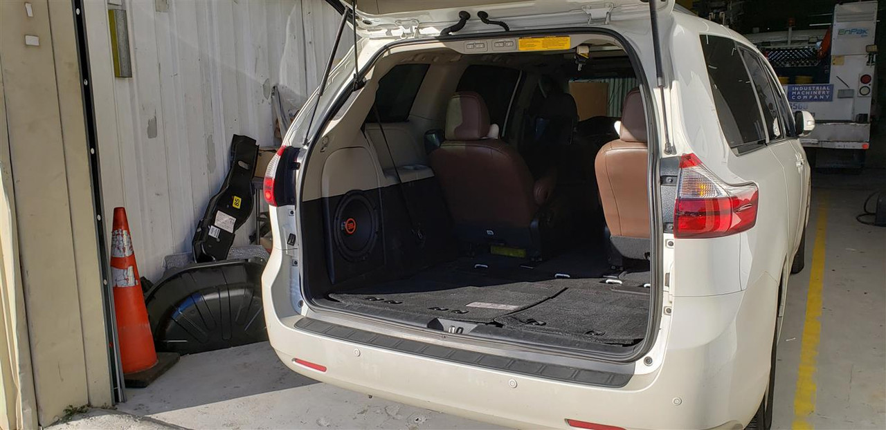

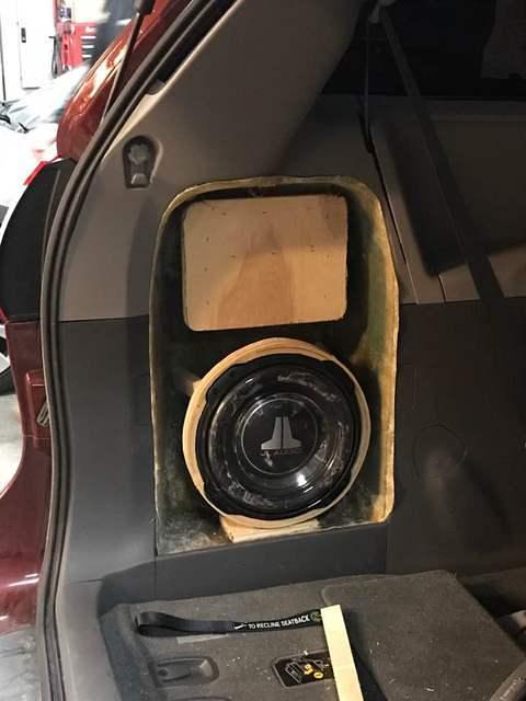

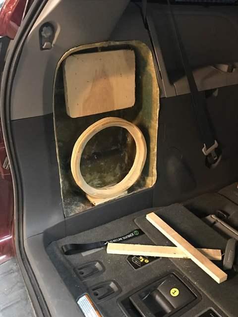

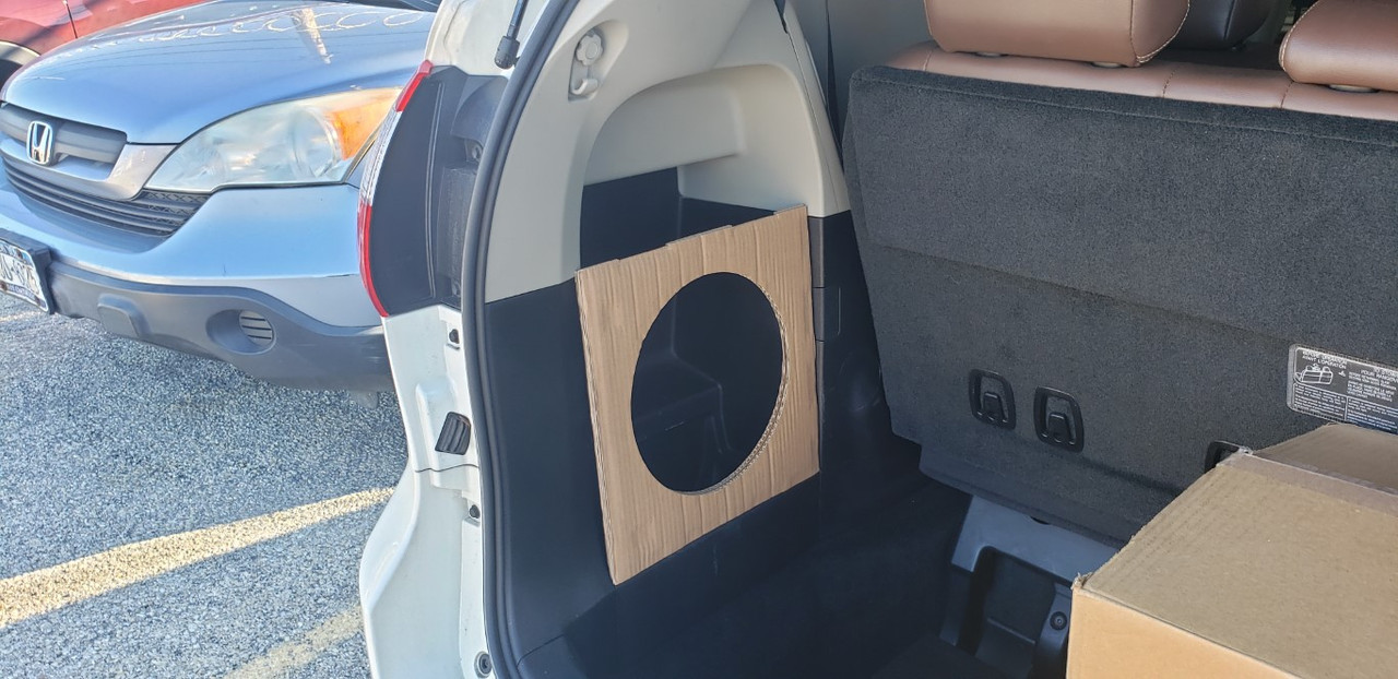

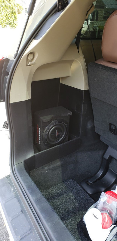

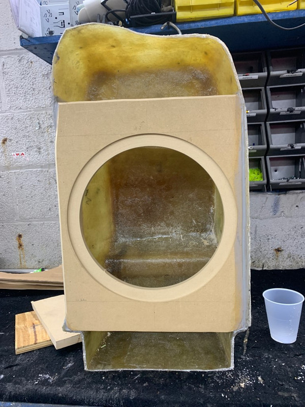

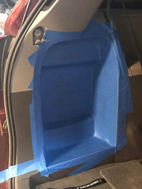

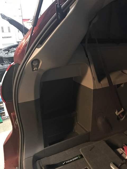

im week into ownership of 16 se and im eyeing that same spot for a woofer. found few more screen shots to spark interest. ill get to it eventually. probably fall.project fiberglass 101..

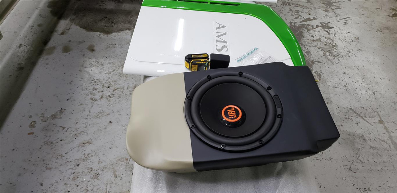

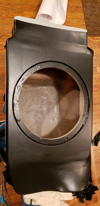

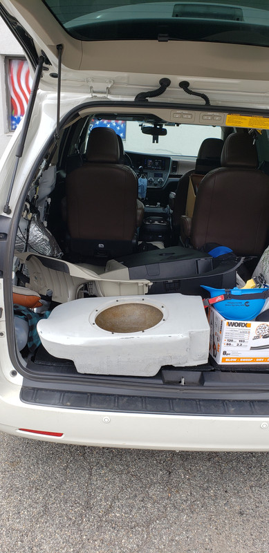

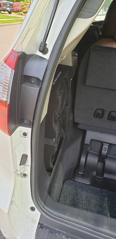

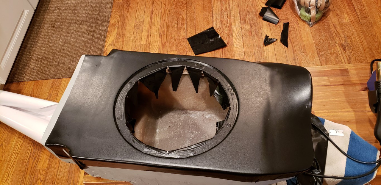

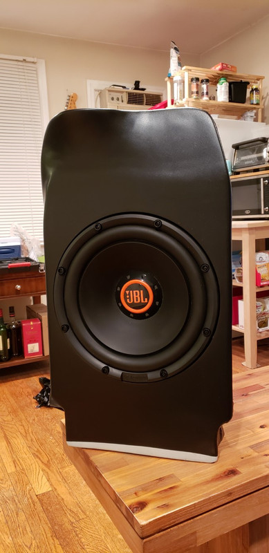

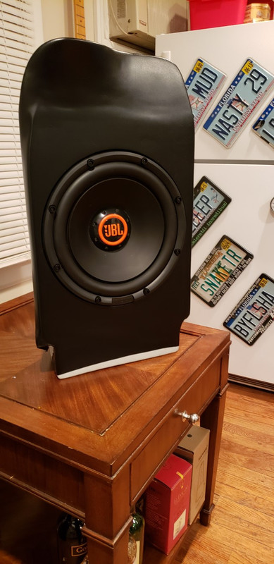

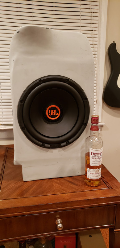

Honestly, I'm not expecting anything spectacular from this enclosure, but I know it will be more than sufficient for my ears as I'm not a basshead by any stretch (outgrew that phase a LONG time ago)

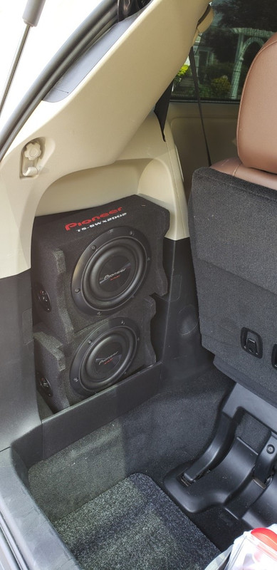

I'm currently running a pair of 8 inch subs in separate sealed downfire enclosures and even those are overkill for me.
In fact, one 8 would be perfect, but if I'm gunna go through the hassle of building this thing, I'm just gunna use the biggest sub I can fit and be done with it.

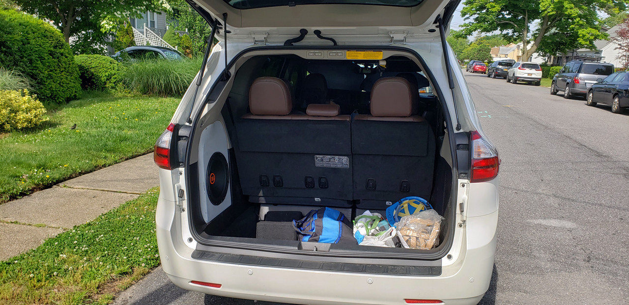

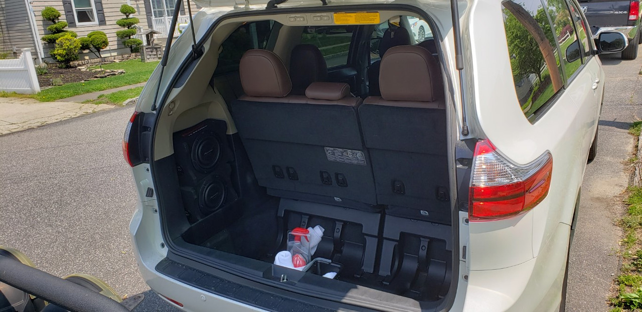

I've experimented with positioning and it makes quite a difference.
With both subs sitting on the trunk floor spead out to the corners, the sound is deeper and louder than when they're sitting inline between the middle row captains chairs (just in front of the 3rd row)
When mounted within the cubby hole, the sound wasn't nearly as deep as when on the trunk floor, but deeper than the middle row mounting.
I'm guessing the use of the large trunk area and corner loading makes th ebiggest difference.
I also tried out my buddy's pair of 12" subs in separate ported enclosures and the sound was super loud and boomy, but not nearly as clean as the 8's
Different positions made a difference in how loud it got, but nothing really helped with SQ

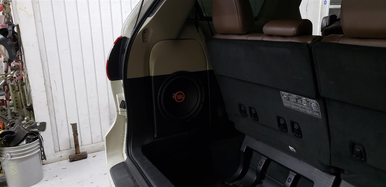

Hoping the single 12 in a sealed enclosure will workout better.

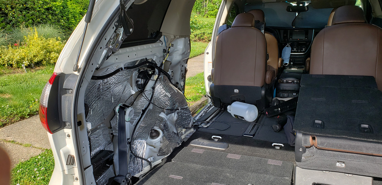

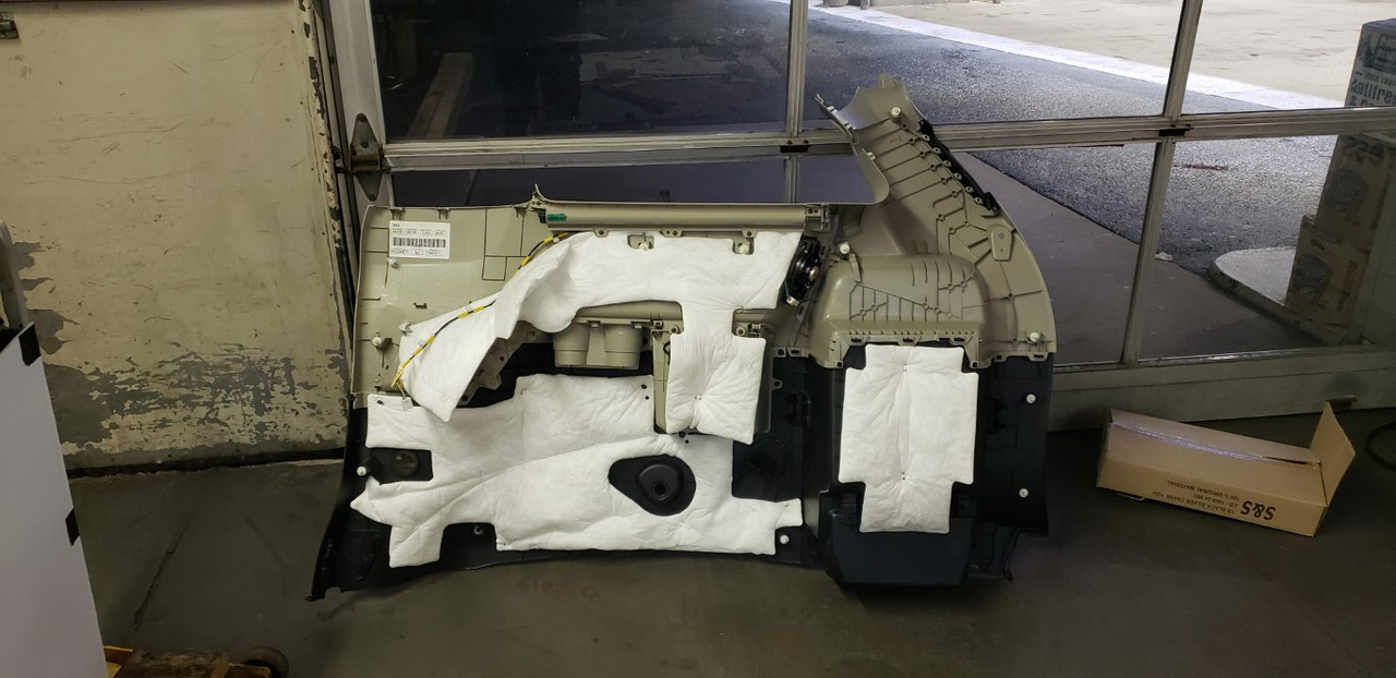

Ordered some knock-off Dynamat and will be covering what I can before putting the panel back on
I sees. I haven't done much experimenting with mine. Once i get off my a$$ and least install an amp, I can do some listening. I won't lie...I'm holding on to my basshead ways of the past. I have a 50 mile one way drive to work (in D.C. traffic) so a little extra output would make the miles go by just a little faster. Plus you need the bass to have a proper trap-a-thon.
I'm still getting a custom console made, but the ported skar 10 in my garage is going in as a placeholder.
oh and sound deadening is a must. I'll end up doing at least the doors at the same time as the amp(s).
