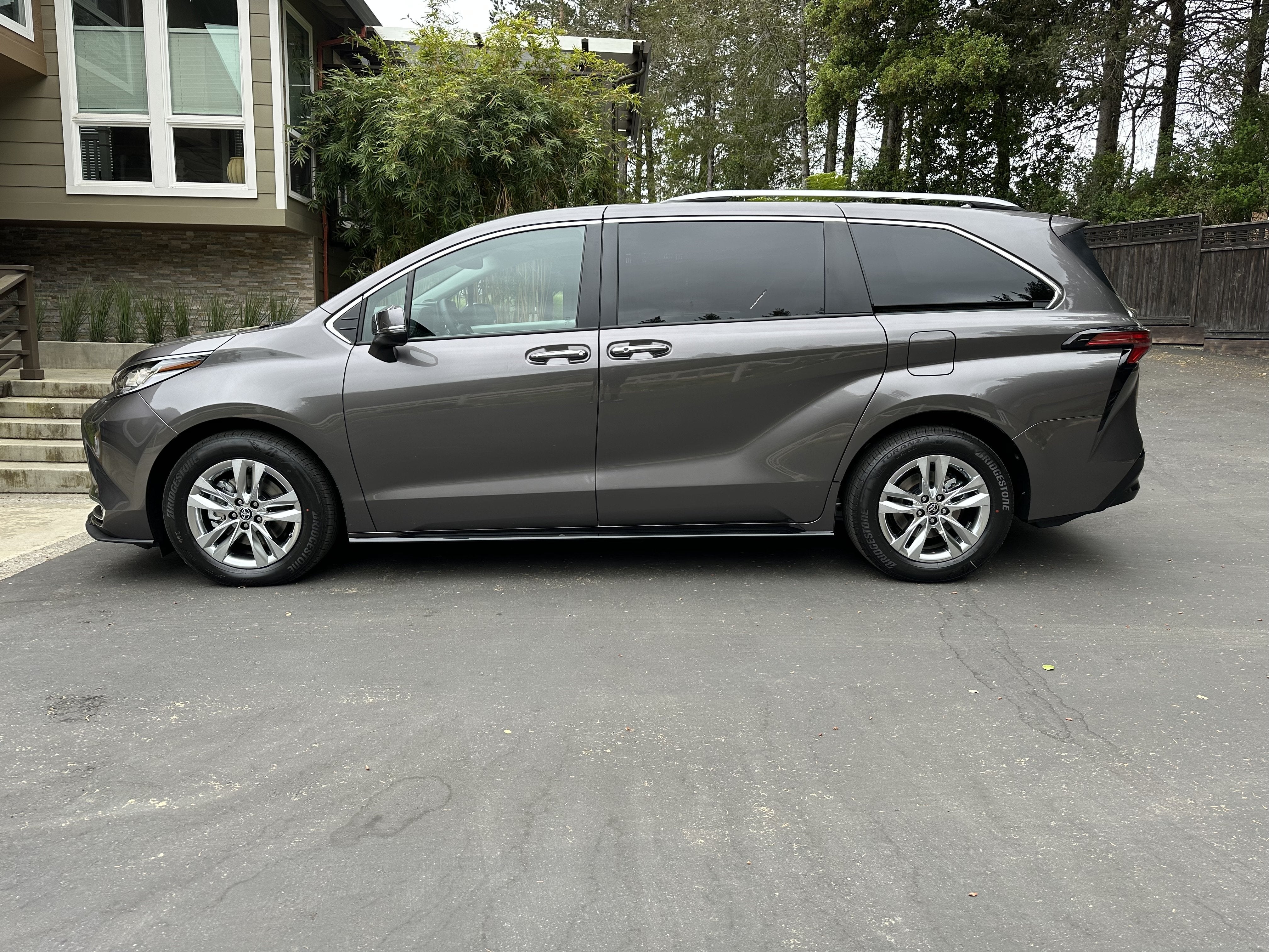

Aftermarket Lexus Rx350 F sport clones. With the RSR drop looks just right. Put on Hankpok EVO ION AS tires. (OEM size for 20's that come on Sienna) technically designed for EVs and Hybrids. Shop recommended them so trying them out. Pretty good so far. No weight savings, but maybe in the future I'll go with some flow formed lightweight wheels.
2022 Toyota Sienna Limited AWD Hybrid Stock wheels have a Chrome Cap over Black aluminum.
