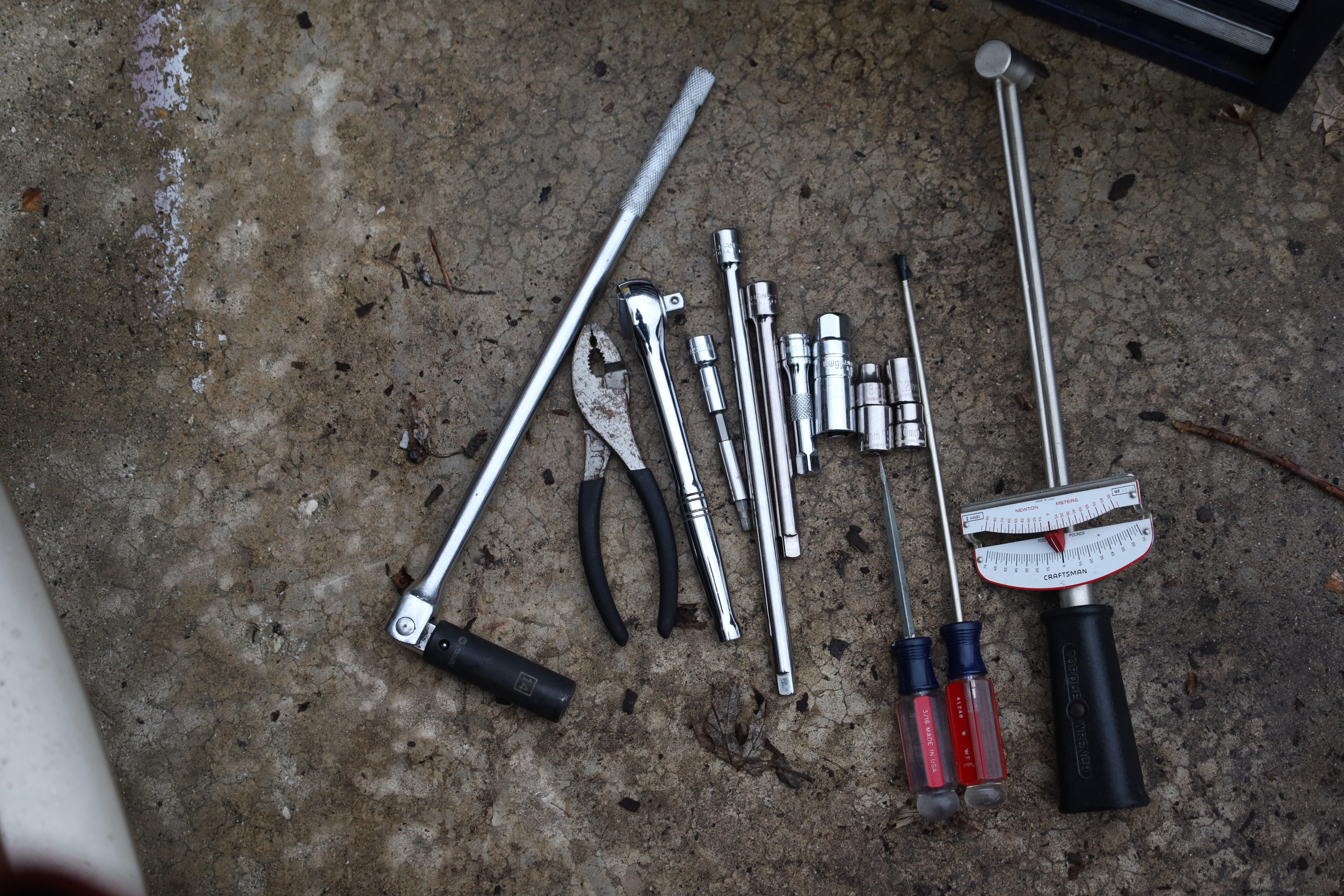

This is every single tool I used to change the plugs on my 2014 Sienna:
Full details on parts & tools required, and tons of pictures and text walking you through it on my thread here:
It’s certainly much less of a pain than doing the water pump was!
Whichever way the OP goes, 100% agree don’t get the cheapest parts, and change at least the three rear coils. The front coils can be changed in two minutes on the side of the road with no tools if needed, but not the rear ones…
