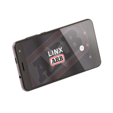

The Linx was chosen to not only to finely control the compressor’s output, but also control each suspension helper airbag’s inflation to level the van from front-to-back and also side-to-side. Air bags have yet to be installed, but are a future mod to aid the vehicle’s handling and ride quality while towing. Additionally, the Linx can monitor the 12v battery’s charge status/health, trailer TPMS sensors (for our future camping trailer), 12v fridge/freezer status, and control electrical accessories via six relay trigger outputs.
For those unfamiliar, here’s some manufacturer info regarding the Linx and a stock photo:

ARB CKMA12 high-performance 12v compressor / Linx Vehicle Accessory Interface install (Part #4):
Once the compressor and Linx were installed and bench tested with the control unit, it was time to install the control unit’s gimbal mount in the front of the cabin.
Here’s a stock photo of the gimbal mount attached to the back of the control unit. This angle gives you an idea of the design which I’ll expound on a bit more below:
The Linx control unit is a sterilized Android phone, sans SIM card, in a custom case with a magnet compatible disc on the back. It attaches to the Linx gimbal mount via four powerful buttonhead disc magnets on the mount itself. The gimbal mount is sturdy and rotates around a ball socket to place the screen at the best angle possible in relation to the driver. The control unit connects to the Linx via a USB 2.0 data link cable - the supplied 6’ cable was not long enough to reach the Linx at the rear of the vehicle, so I extended it with a 10’ extension cable found via Amazon. The 10’ extension was just long enough to reach the Linx with no slack to spare. I wrapped the USB cable in flexible conduit and ran it behind the front kick panel, under the drivers front and sliding door sill trim, and behind the left rear quarter panel trim - securing it along the way with velcro cable management tape.
The other cool feature of the control unit is it is Bluetooth enabled, which allows it to connect to the Linx wirelessly as a redundant form of communication if the USB cable fails. The control unit can also be detached from the mount and removed from the vehicle to visually observed actions like the inflation of rear airbags from outside the vehicle to ensure the appropriate amount of chassis leveling is achieved - very helpful. It also allows the control unit to be detached and stored outside the vehicle for safekeeping when the vehicle is parked for long periods of time.
I decided to mount the control unit below the radio on the flat, “storage ledge” to the left of the wireless phone charger. Some high-strength 3M molding tape was applied to the bottom of the mount and the base secured to the trim piece, flush with the vehicle’s data USB port.
